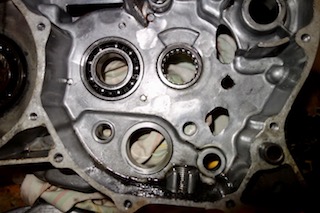

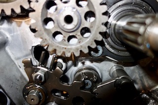

I bought a TY250 B The gear change was very loose, I took it apart, and the "Stopper screw" was missing, and there was a hole in the casing.
Does anyone has any experience with welding the casing. And then tap in a new thread.

I've got two 250B cases apart at the moment, one is good but the other is like yours. I'm planning on making a jig using the good case to hold the broken piece in place whilst I repair the broken case. Do you still have the broken aluminium "stud" that the "stopper screw" threads into? I've just got to work out how to get that cylindrical roller bearing out of the case......
This is a common point of failure on these motors it seems.
Ross.
Ross.

Not the best stuff to weld but it is quite possible. The position of the thread should be easy to find by putting the selector fork in the middle at the drum end and marking the spot.
