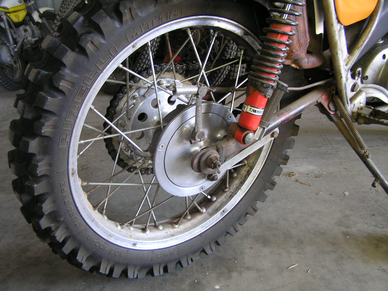

Postby David Lahey » Wed Aug 05, 2009 5:40 pm
Greg does your M213 rear hub look like this one? (photo is of an M138)

Posts: 701
Postby Greg Harding » Wed Aug 05, 2009 10:37 pm
Just replying in order as they came.
Firstly David, Alpina rear wheel is the same as the photo you posted except no holes in hub. Sprocket has 9 mounting holes and you probably guessed Alpina gearing is higher than Sherpa T. According to specs 2nd in Sherpa T same as 1st in Alpina, I have 50 teeth by 11 teeth at the moment. Plus I have managed to break backing plate where the stay mounts and ends off brake shoes! Must be hard on equipment!
