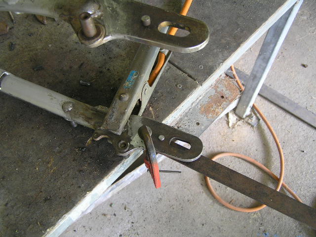

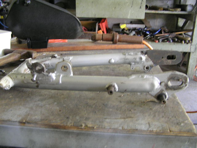

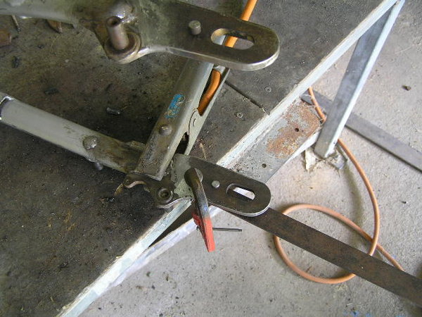

Had some workshop fun last weekend - just another page in the endless "fiddling with my TY175" story
first side tacked in position
fitting the snail cam stops

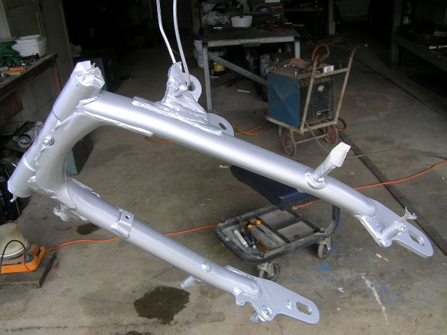

painting

The standard TY175 frame is short and has slow steering. I find the standard combination is pretty good except for uphill turns. The first set of frame mods made the steering lighter in turns so is a bit easier to control when going very slowly with a lot of load on the front. It also moved the bars forwards, which improved the ergonomics but uphill turns were still tricky. The motor mods made the motor much more snappy which exaggerated the instability in uphill turns. The swingarm mod has put noticably more weight on the front end and it now turns uphill much better. The steering is still nice and light even when loaded. The swingarm lenthening has also softened the rear suspension a bit, due to the increased wheel travel.
I rode the modified TY175/205 back to back today with the 250 Majesty and the handling and steering is very similar, but the TY175/205 is lighter-feeling overall.
