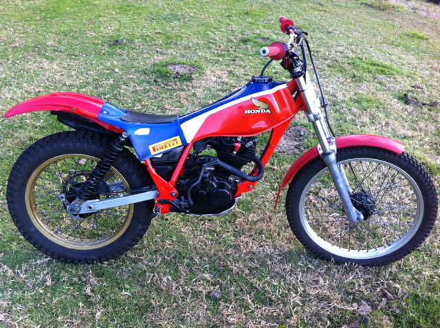

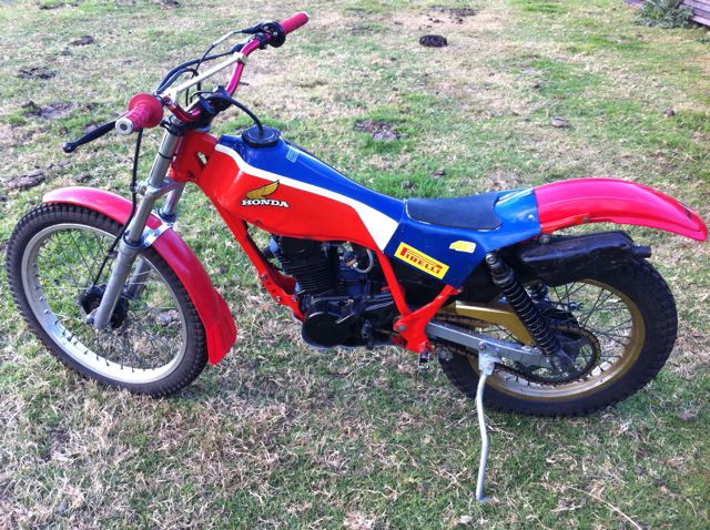

Just got a new to me TLR 200 and I need some advice on parts and improvements.
Does anyone have a list of year ID numbers for these to check its birthday? Frame number is MD09 1009195 and the Engine number is MD09E-1012897.
What size sprockets are people running for trials? Mine is running a 12/44 at the moment and I read a reference to a 10/50 in the USA.
Standard shocks would be fine on an XR but a bit hard and slow for trials so experience here would help.
Front fork mods could be a big help as well.
Carb. is a bit fluttery and I put this down to the open heart surgery on the rear muffler so maybe a bit of Jetting will cure this as well.
The dents in the tank appear to be "Factory" and provided for knee gripping to tame the savage power delivery.
I am open to all input and think it should be a lot of fun to have a trials bike again. I rode with Western Districts in Brisbane in the Eighties but not a lot since. I did baby sit a pink TY 250 (disc Front) for a while which was fun and then a later Sherco 250 which was a handful at times.
Fettling a TLR 200
