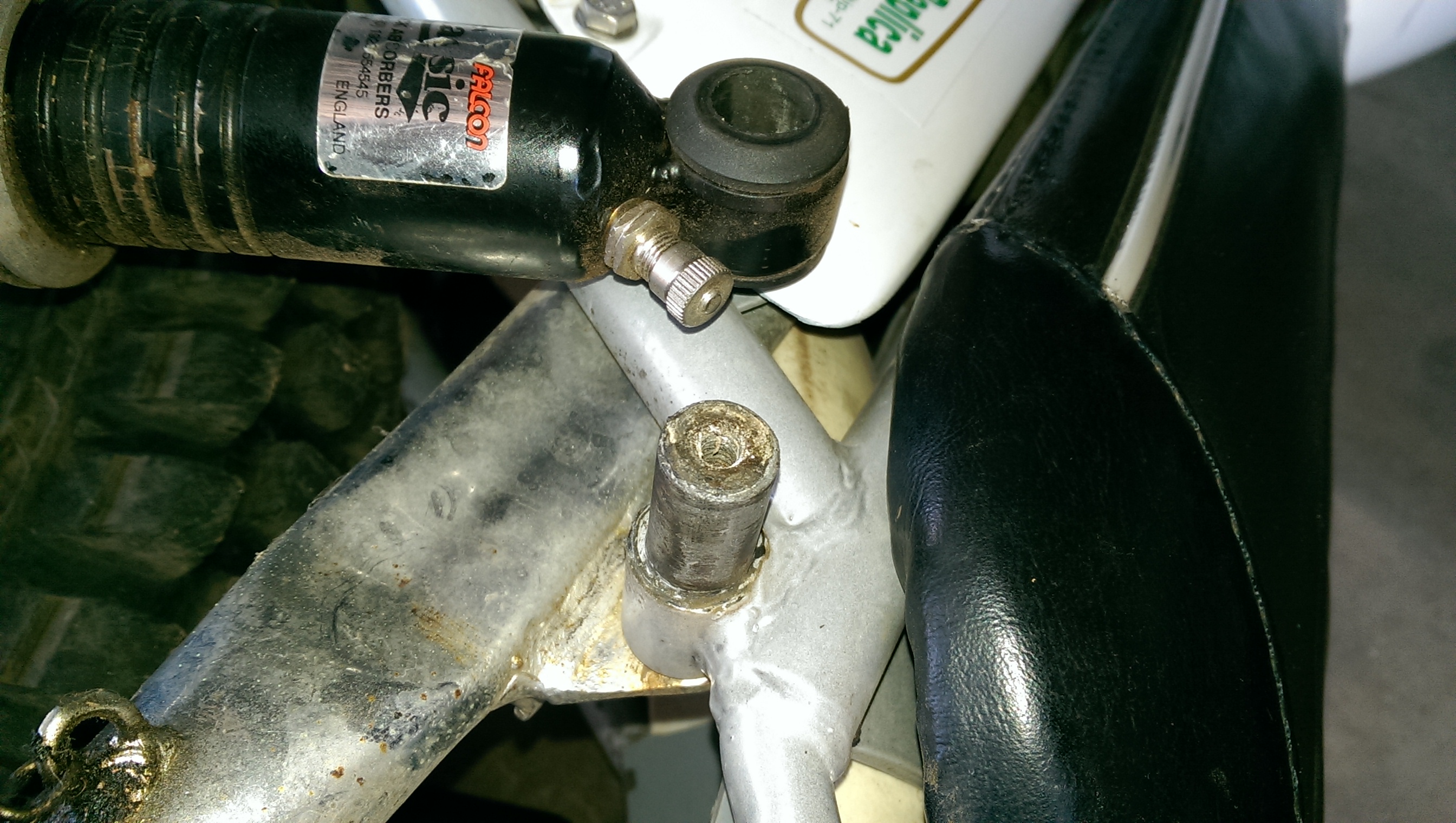

My MAR mk2 has 14mm top shock mount posts and 12mm bottom posts, is that standard ? Don Newell, who sells the Falcon shocks tells me that 12mm top and bottom is the norm for the :ossa MAR. Maybe my top mounts have been modified by a previous owner but all the welds around these posts look original, it's got me stumped!
Next time anyone has a shock off their :ossa and a set of verniers handy could you measure the post diameters please and let me know of your findings. Don suggested he could drill out the top rubbers/bushes to 14mm to make them fit, but if I'm going to fork out nearly $400 for a new set of Falcons I want them to fit straight on with no modifications.

Postby David Lahey » Fri Oct 03, 2014 9:29 pm
My frame is a 1974/75 Explorer and the top mounts are bigger diameter than the bottom mounts. I bought steel-bodied trial classic 360mm Falcons and drilled the top end bushes bigger. Yes bottom mounts are 12mm.
Tops probably 14mm but have not measured them since drilling them out 8 years ago and don't remember. Will measure tomorrow if no-one else answers.

Postby Rod » Fri Oct 03, 2014 10:28 pm
Your a champ David, thanks for reply. $395 Don tells me. I'm going to take the bike to him on Monday and we'll see how things fit, or don't fit.

Postby David Lahey » Sat Oct 04, 2014 12:22 pm
top mounts are 15mm diameter. Photo coming if I can get my phone to cooperate
