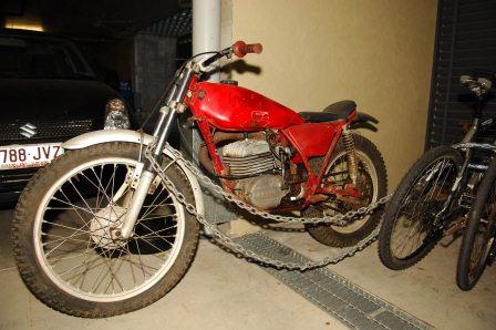

I have a 158 framed 190 engined Bultaco Sherpa 250.
Looks Like this, only worse.

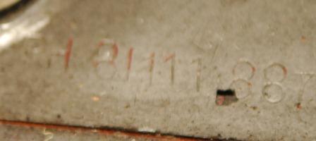

It's had a rough life! Note that part number on the side casing is how I identified the engine. I googled the number and some guy in spain is restoring the same engine number.
The main engine number on the bike is 811######which is gobbledygook.

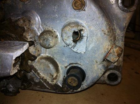

Most pressing are these..
Engine casing holed due to chain off at some stage. It still holds oil and the oil doesn't seem water contaminated even after a pressure wash when everything els was water contaimated.
They are pretty tought these old bikes.
That side cover is busted as welll... Actually. EVERYTHING is busted. It's just degrees of BUSTED that I am workling with.
Should I try to weld... Obvioulsy replacing the side casing is one suggestion. Any others? Weld and machine the bearing again?

I have had this bike since about 1993 and it's been stored since 1997 in a damp environ.

The good thing about Bultacos is that pretty much everything you need is available and they are virtually bullet proof. Over the years I have had various parts of Bultaco alloy welded by different welders and never had a problem. The two broken components you have are common issues and can be repaired. Parts can be obtained from Peter Schoene http://www.bultacoaustralia.com/ or Don Newell http://www.newellmotorcycles.com.au/Bultaco.htm

John Tate from John Tate Automotive at Coopers Plains will be able to assist with repairing the casing and fork. He can also separate the tank and restore it. He mainly works on vintage motocrossers and I have seen him restore and repair bikes in far worse condition than yours!

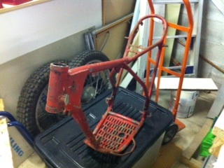

Here's what's left after the weekend.

It may be a trick of the light, but I reckon you have a bent frame.
The top tube looks bent at the back of the headstock gusset as if it has been ridden into a brick wall. This will steepen the head angle and compromise the lazy and predictable handling that these tractors - oops sory, bikes! - are renowned for.
Have a look at the down tube too, that will have taken some stick.
You dont need a frame specialist to sort it, just a competent fabricator/welder with a bit of sympathy and a good eye..
